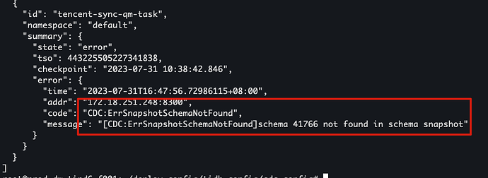

TiCDC报错:[CDC:ErrSnapshotSchemaNotFound]schema 41766 not found in schema snapshot
早上10点多突然,TiCDC任务都停止了,都是一样的报错。
看日志的话,也是毫无头绪:
[2023/07/31 16:35:46.219 +08:00] [ERROR] [changefeed.go:240] ["an error occurred in Owner"] [namespace=default] [changefeed=tencent-sync-qm-task] [error="[CDC:ErrSnapshotSchemaNotFound]schema 41766 not found in schema snapshot"] [errorVerbose="[CDC:ErrSnapshotSchemaNotFound]schema 41766 not found in schema snapshot\ngithub.com/pingcap/errors.AddStack\n\tgithub.com/pingcap/errors@v0.11.5-0.20220729040631-518f63d66278/errors.go:174\ngithub.com/pingcap/errors.(*Error).GenWithStackByArgs\n\tgithub.com/pingcap/errors@v0.11.5-0.20220729040631-518f63d66278/normalize.go:164\ngithub.com/pingcap/tiflow/cdc/puller.(*ddlJobPullerImpl).handleRenameTables\n\tgithub.com/pingcap/tiflow/cdc/puller/ddl_puller.go:252\ngithub.com/pingcap/tiflow/cdc/puller.(*ddlJobPullerImpl).handleJob\n\tgithub.com/pingcap/tiflow/cdc/puller/ddl_puller.go:360\ngithub.com/pingcap/tiflow/cdc/puller.(*ddlJobPullerImpl).Run.func2\n\tgithub.com/pingcap/tiflow/cdc/puller/ddl_puller.go:123\ngolang.org/x/sync/errgroup.(*Group).Go.func1\n\tgolang.org/x/sync@v0.1.0/errgroup/errgroup.go:75\nruntime.goexit\n\truntime/asm_amd64.s:1594"]

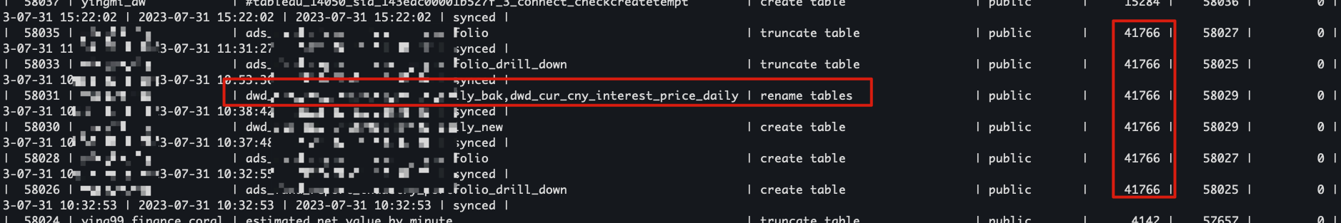

admin show ddl jobs发现正好是执行一个RENAME DDL后触发的,执行的DDL是RENAME TABLE a TO a_bak, a_new TO a;,表所在库的schema_id正好就是41766
尝试了一下,把changefeed删除,报错依旧存在,还有其他办法恢复么??
另外,现有的几个changefeed其实并没有同步schema_id为41766的库。。。
