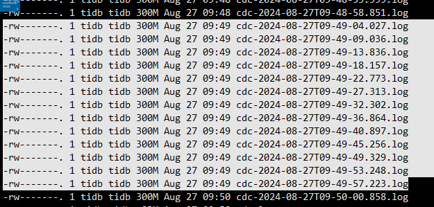

【复现路径】起了114个同步任务都显示成功,并且list查看状态都是normal
【遇到的问题:问题现象及影响】但在log路径下一直产生日志文件,日志内容就是[2024/08/21 09:48:31.344 +08:00] [WARN] [sink.go:488] [“meet nil column data, should not happened in production env”] [cols=“[{"column_id":1,"value":2594073387516685639},{"column_id":2,"value":"NDIzZThmMTE5YjU5YzI3MmJkMWNjN2JlZDUxZmYwOGE="},{"column_id":3,"value":"MTMxNTM1NDky"},{"column_id":4,"value":"MjAyMw=="},{"column_id":5,"value":"NDQwMzA2MTE3MDE2NzIz"},{"column_id":6,"value":"OTE0NDAzMDBNQTVESEs2UjQ3"},null,{"column_id":8,"value":"5rex5Zyz5biC5aSn5qKB5Zu95Yib56eR5oqA5pyJ6ZmQ5YWs5Y+4"},{"column_id":9,"value":"MjAyM+W5tOW6puaKpeWRig=="},{"column_id":10,"value":"MjAyNC0wOC0xMg=="},{"column_id":11,"value":null},{"column_id":12,"value":null},{"column_id":13,"value":null},{"column_id":14,"value":"MTM1MTA0OTIzMjE="},{"column_id":15,"value":"MTA0NjQ5NDIwNEBxcS5jb20="},{"column_id":16,"value":null},{"column_id":17,"value":null},{"column_id":18,"value":null},{"column_id":19,"value":null},{"column_id":20,"value":null},{"column_id":21,"value":"5rex5Zyz5biC5a6d5a6J5Yy65rKZ5LqV6KGX6YGT5aOG5bKX5Y2O576O5bGFM+agizIwMDg="},{"column_id":22,"value":"55S15a2Q5Lqn5ZOB5Y+K5ZGo6L656YWN5Lu255qE5oqA5pyv5byA5Y+R5LiO6ZSA5ZSu77yb55S16ISR5ZGo6L656YWN5Lu244CB5omL5py66YWN5Lu244CB56e75Yqo55S15rqQ44CB6Z+z5ZON44CB55S15a2Q5raI6LS55ZOB5Y+K55S15a2Q56S85ZOB55qE6ZSA5ZSu77yb5Zu95YaF6LS45piT77yM6LSn54mp5Y+K5oqA5pyv6L+b5Ye65Y+j44CCKOazleW+i+OAgeihjOaUv+azleinhOOAgeWbveWKoemZouWGs+WumuinhOWumuWcqOeZu+iusOWJjemhu+e7j+aJueWHhueahOmhueebrumZpOWklu+8iQ=="},null,{"column_id":24,"value":"NTE4MDAw"},{"column_id":25,"value":null},null,null,{"column_id":28,"value":null},{"column_id":29,"value":"5ZCm"},{"column_id":30,"value":"5ZCm"},{"column_id":31,"value":"5ZCm"},{"column_id":32,"value":"5piv"},null,{"column_id":34,"value":"5byA5Lia"},null,null,{"column_id":37,"value":null},{"column_id":38,"value":null},null,null,{"column_id":41,"value":null},{"column_id":42,"value":null},{"column_id":43,"value":null},null,{"column_id":45,"value":null},{"column_id":46,"value":null},null,null,null,null,null,{"column_id":52,"value":null},{"column_id":53,"value":null},null,null,null,null,null,null,{"column_id":60,"value":"2024-08-21 09:37:31"},{"column_id":61,"value":"2024-08-21 09:37:31"},{"column_id":62,"value":null},null]”] [tableInfo=“TableInfo, ID: 3643, Name:xmcicdata.t_biz_ent_report, ColNum: 63, IdxNum: 5, PKIsHandle: true”]

你好,我测试是可以同步数据的。但我起了很多的同步任务,担心会漏数据所以想找个解决方案。而且这个日志生成速度非常快,基本一个分钟就能写4G左右的日志文件。内容都是各种表的这种报错。
请问tidb有限制日志大小功能吗

有,https://docs.pingcap.com/zh/tidb/stable/tidb-configuration-file#logfile
看一下楼上回复的贴子,里面的参数配置可以设置日志大小和数量

关于日志问题解决了,谢谢

我改下帖属性吧。感觉可以优化。日志太多也不合理。
后续跟踪下这个 ISSUE 即可。The log prints too much when using CDC sync column with nil values to Kafka. · Issue #11537 · pingcap/tiflow · GitHub
