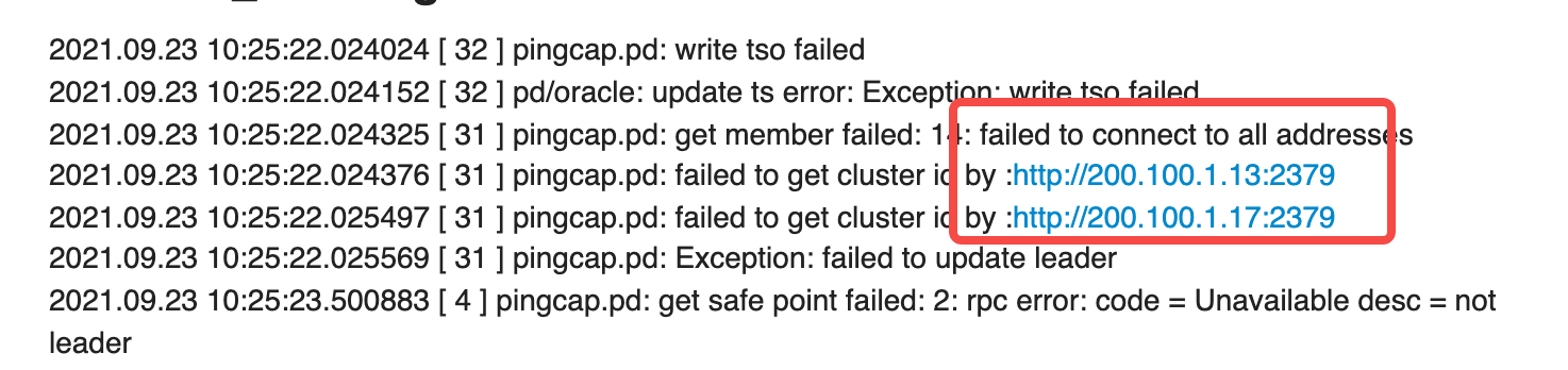

vi tiflash_error.log
2021.09.23 10:25:22.024024 [ 32 ] pingcap.pd: write tso failed
2021.09.23 10:25:22.024152 [ 32 ] pd/oracle: update ts error: Exception: write tso failed
2021.09.23 10:25:22.024325 [ 31 ] pingcap.pd: get member failed: 14: failed to connect to all addresses
2021.09.23 10:25:22.024376 [ 31 ] pingcap.pd: failed to get cluster id by :http://200.100.1.13:2379
2021.09.23 10:25:22.025497 [ 31 ] pingcap.pd: failed to get cluster id by :http://200.100.1.17:2379
2021.09.23 10:25:22.025569 [ 31 ] pingcap.pd: Exception: failed to update leader
2021.09.23 10:25:23.500883 [ 4 ] pingcap.pd: get safe point failed: 2: rpc error: code = Unavailable desc = not leader

你确定 你 tiflash 和 tidb- server/pd-server 的端口是 ok 的吗?(日志有明显报错啊)
[root@localhost tiflash-9000]# telnet 200.100.1.13 2379
Trying 200.100.1.13…
Connected to 200.100.1.13.
Escape character is ‘^]’.
[root@localhost tiflash-9000]# telnet 200.100.1.13 4000
W
(��.tt|~K.>YmJ{mysql_native_password
[root@localhost tiflash-9000]# telnet 200.100.1.13 10080
^C
Connection closed by foreign host.
