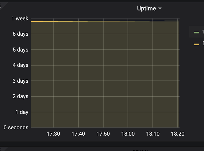

2、查看 progress 数值不变化,同时查看 tiflash_cluster_manager.log 日志看到 flash_region_count 值没有变化,监控面板下检查 UpTime 指标查看 TiFlash 进程是否正常
TiFlash → Server

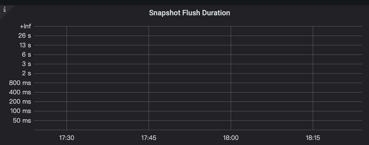

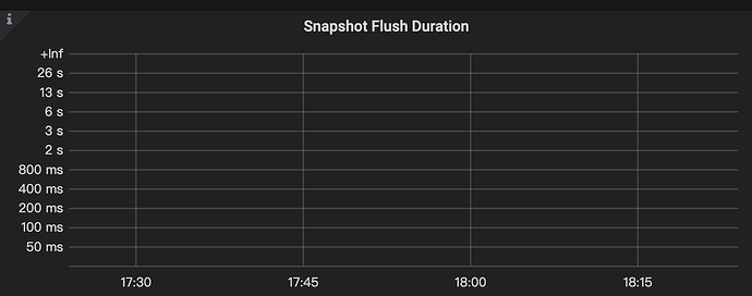

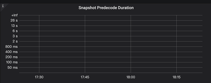

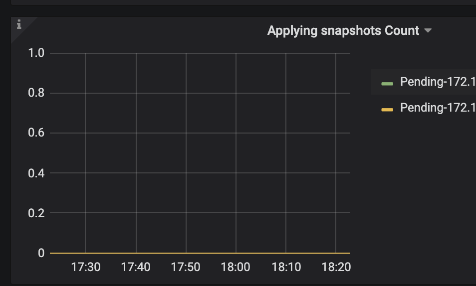

- 观察
Grafana中的TiFlash-Summary看板,Raft 中“Applying snapshots Count”, “Snapshot Predecode Duration”, “Snapshot Flush Duration”,反映 TiFlash 通过ApplySnapshot接收数据的并发度、apply 耗费的时长;
TiFlash-summary → raft → Applying snapshots Count
TiFlash-summary → raft → Snapshot Predecode Duration
TiFlash-summary → raft ->Snapshot Flush Duration

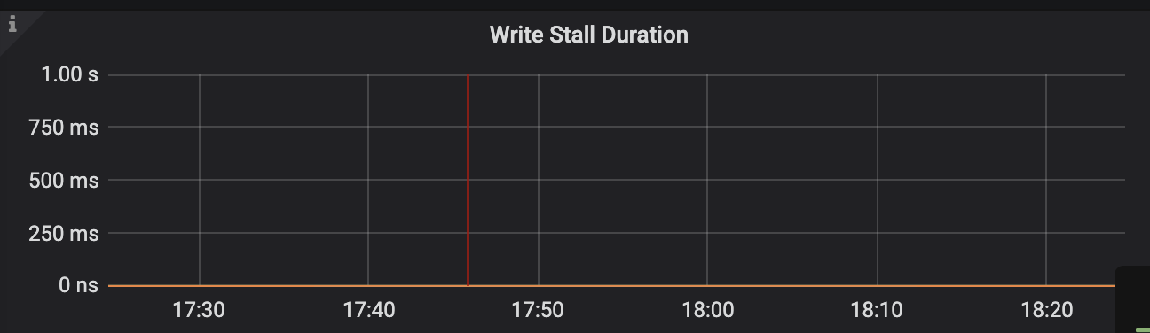

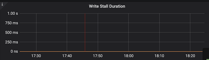

Storage Write Stall中的“Write Stall Duration”是否写入太频繁,导致出现了Write Stall现象
TiFlash-summary → Storage Write Stall ->Write Stall Duration
