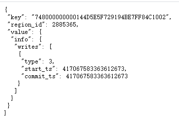

  • 【问题描述】:原来由于TiDB当中有很多的empty region,但还不合并,所以将这个值改为了tnx,但今天发现出错了,具体原还还不太清楚。后来改成raw也不行。那个task还是出错。
    所以需要知道这个参数要改成什么合适,对整体TiDB有什么影响,是不是可以随意更改?(因为已经更改了,不知道有什么影响)

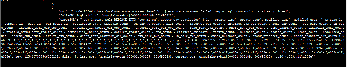

使用query-status还能查出来数据,但使用qurey-error,就会显示出很多很多的sql语句,只是将最下面的截取了一下

  1. 请问当前同步正常吗? 能否反馈 query-status 完整结果,多谢。
现在还有异常信息,正在想着,是不是要重新做这个task呢

3、query-status完成信息:
query-status cop_m1_all_cm
“result”: true,
“msg”: “”,
“workers”: [
“result”: true,
“worker”: “10.7.110.98:8262”,
“msg”: “”,
“subTaskStatus”: [
“name”: “cop_m1_all_cm”,
“stage”: “Paused”,
“unit”: “Sync”,
“result”: {
“isCanceled”: false,
“errors”: [
“Type”: “ExecSQL”,
“msg”: “[code=10006:class=database:scope=not-set:level=high] execute statement failed: REPLACE INTO cop_m1_cm.cm_ops_maintain_dashboard (id,company_id,statistic_type,title,content,param,update_time,sub_statistic_type) VALUES (?,?,?,?,?,?,?,?);: Error 1105: unexpected resolve err: abort:"Txn(Mvcc(Committed { commit_ts: TimeStamp(417066463405801519) }))" , lock: key: {tableID=1990491, handle=1263350373318930433}, primary: {tableID=1330526, handle=1266845872634466306}, txnStartTS: 417066463379587105, lockForUpdateTS:0, ttl: 3074, type: Del

\t/home/jenkins/agent/workspace/build_dm_master/go/src/github.com/pingcap/dm/pkg/conn/baseconn.go:145
github.com/pingcap/dm/syncer.(*DBConn).executeSQLWithIgnore.func2
\t/home/jenkins/agent/workspace/build_dm_master/go/src/github.com/pingcap/dm/syncer/db.go:260
github.com/pingcap/dm/pkg/retry.(*FiniteRetryStrategy).Apply
\t/home/jenkins/agent/workspace/build_dm_master/go/src/github.com/pingcap/dm/pkg/retry/strategy.go:71
github.com/pingcap/dm/pkg/conn.(*BaseConn).ApplyRetryStrategy
\t/home/jenkins/agent/workspace/build_dm_master/go/src/github.com/pingcap/dm/pkg/conn/baseconn.go:203
\t/home/jenkins/agent/workspace/build_dm_master/go/src/github.com/pingcap/dm/syncer/db.go:255
\t/home/jenkins/agent/workspace/build_dm_master/go/src/github.com/pingcap/dm/syncer/db.go:282
github.com/pingcap/dm/syncer.(*Syncer).sync.func3
\t/home/jenkins/agent/workspace/build_dm_master/go/src/github.com/pingcap/dm/syncer/syncer.go:979
\t/home/jenkins/agent/workspace/build_dm_master/go/src/github.com/pingcap/dm/syncer/syncer.go:1011
github.com/pingcap/dm/syncer.(*Syncer).Run.func2
\t/home/jenkins/agent/workspace/build_dm_master/go/src/github.com/pingcap/dm/syncer/syncer.go:1092
runtime.goexit
\t/usr/local/go/src/runtime/asm_amd64.s:1357”,
“error”: null
“detail”: null
“unresolvedDDLLockID”: “”,
“sync”: {
“totalEvents”: “2296562”,
“totalTps”: “0”,
“recentTps”: “0”,
“masterBinlog”: “(mysqlslave-bin.000204, 68674683)”,
“masterBinlogGtid”: “”,
“syncerBinlog”: “(mysqlslave-bin|000001.000189, 782029641)”,
“syncerBinlogGtid”: “”,
“blockingDDLs”: [
“unresolvedGroups”: [
“synced”: false
“relayStatus”: {
“relaySubDir”: “965117b9-e61f-11e8-ba1e-0242ac110002.000001”,
“relayBinlog”: “(mysqlslave-bin.000204, 68674683)”,
“relayBinlogGtid”: “”,
“relayCatchUpMaster”: true,
“stage”: “Running”,
“result”: null
“sourceID”: “cop-m1”

  1. 麻烦再查一下 curl http://{TiDBIP}:10080/mvcc/key/{db}/{table}/1266846852033810434 的结果
table id= 1330526, 您可以查一下 select * from INFORMATION_SCHEMA.tables where tidb_table_id=1330526; 确认表名和库名
日志暂时没去查,收集起来有些麻烦了,这个查出来了。
http://10.7.110.103:10080/mvcc/key/cop_m1_cm/home_page_remind_statistics/1266846852033810434
