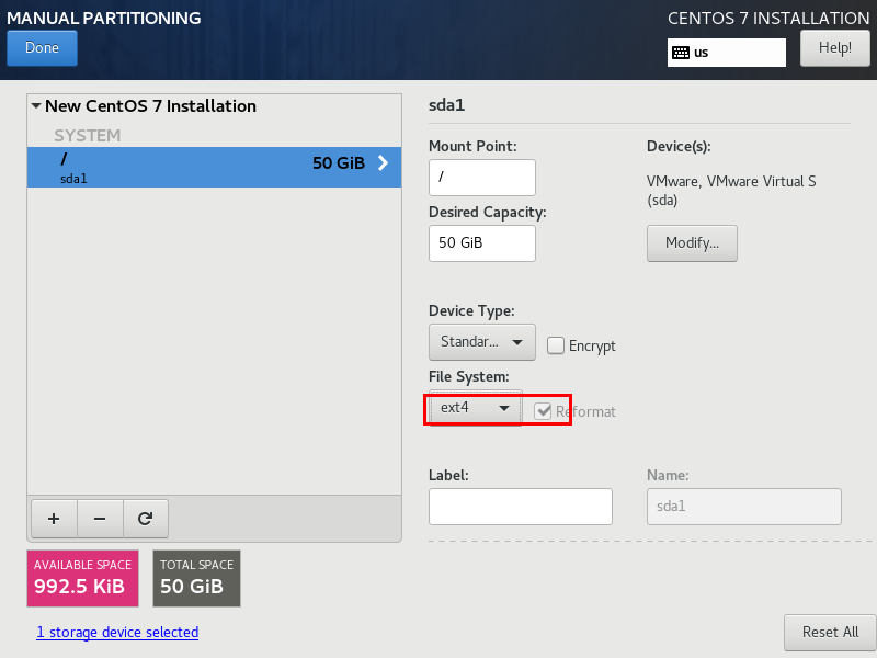

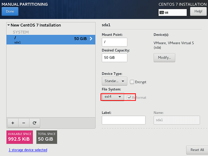

虚拟机最小化安装,网卡static,硬盘分区如下图,先安装一个虚拟机pd当模板机,其他4个虚拟机完整克隆复制

配置文件系统为 ext4,参数nodelalloc,noatime
[root@PD ~]# df -h
Filesystem      Size  Used Avail Use% Mounted on
devtmpfs        980M     0  980M   0% /dev
tmpfs           991M     0  991M   0% /dev/shm
tmpfs           991M  9.5M  981M   1% /run
tmpfs           991M     0  991M   0% /sys/fs/cgroup
/dev/sda1        50G  1.5G   46G   4% /
tmpfs           199M     0  199M   0% /run/user/0
[root@PD ~]# cat /etc/fstab
# /etc/fstab
# Created by anaconda on Sat Feb 12 22:09:03 2022
# Accessible filesystems, by reference, are maintained under '/dev/disk'
# See man pages fstab(5), findfs(8), mount(8) and/or blkid(8) for more info
UUID=a0006175-f79e-4ebb-b1de-63160cd856bc /                       ext4    defaults        1 1
# /etc/fstab
UUID=a0006175-f79e-4ebb-b1de-63160cd856bc /                       ext4     defaults,nodelalloc,noatime        1 1
[root@PD ~]# lsblk -f
NAME   FSTYPE LABEL UUID                                 MOUNTPOINT
sda
└─sda1 ext4         a0006175-f79e-4ebb-b1de-63160cd856bc /
sr0

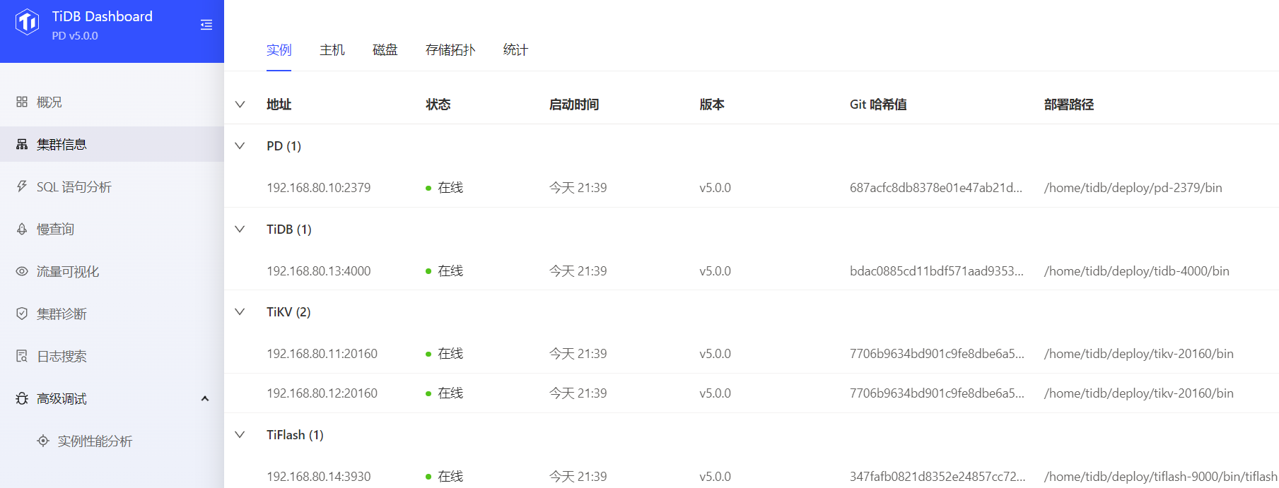

查看集群tidb-test的成员信息
[root@PD ~]# tiup cluster display tidb-test
tiup is checking updates for component cluster ...
Starting component `cluster`: /root/.tiup/components/cluster/v1.9.0/tiup-cluster /root/.tiup/components/cluster/v1.9.0/tiup-cluster display tidb-test
Cluster type:       tidb
Cluster name:       tidb-test
Cluster version:    v5.0.0
Deploy user:        tidb
SSH type:           builtin
Dashboard URL:      http://192.168.80.10:2379/dashboard
ID                   Role          Host           Ports                            OS/Arch       Status   Data Dir                                  Deploy Dir
192.168.80.10:9093   alertmanager  192.168.80.10  9093/9094                        linux/x86_64  Up       /home/tidb/deploy/alertmanager-9093/data  /home/tidb/deploy/alertmanager-9093
192.168.80.10:3000   grafana       192.168.80.10  3000                             linux/x86_64  Up       -                                         /home/tidb/deploy/grafana-3000
192.168.80.10:2379   pd            192.168.80.10  2379/2380                        linux/x86_64  Up|L|UI  /home/tidb/deploy/pd-2379/data            /home/tidb/deploy/pd-2379
192.168.80.10:9090   prometheus    192.168.80.10  9090                             linux/x86_64  Up       /home/tidb/deploy/prometheus-9090/data    /home/tidb/deploy/prometheus-9090
192.168.80.12:4000   tidb          192.168.80.12  4000/10080                       linux/x86_64  Up       -                                         /home/tidb/deploy/tidb-4000
192.168.80.13:9000   tiflash       192.168.80.13  9000/8123/3930/20170/20292/8234  linux/x86_64  Up       /home/tidb/deploy/tiflash-9000/data       /home/tidb/deploy/tiflash-9000
192.168.80.11:20160  tikv          192.168.80.11  20160/20180                      linux/x86_64  Up       /home/tidb/deploy/tikv-20160/data         /home/tidb/deploy/tikv-20160
Total nodes: 7

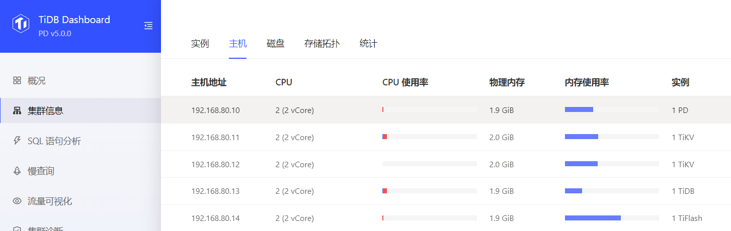

tidb集群系统监控
初始化生成的临时密码8%MW410XPg$&3aT+t9
dashboard: http://192.168.80.10:2379/dashboard
账号root

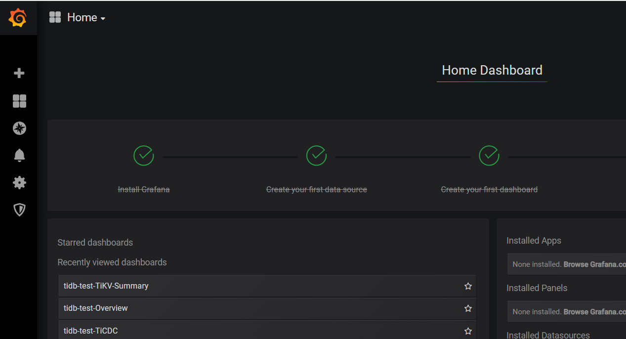

Grafana: http://192.168.80.10:3000
账号admin
密码admin
