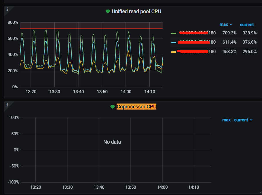

2、以下是热点问题的查看,差别不大,不应该是这个问题

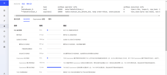

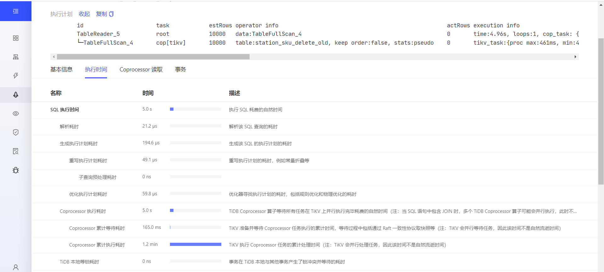

以下内容是上图中执行计划信息:
id               	task     	estRows	operator info                                               	actRows	execution info                                                                                                                                                                                                                                                                      	memory   	disk
TableReader_5    	root     	10000  	data:TableFullScan_4                                        	0      	time:4.96s, loops:1, cop_task: {num: 321, max: 462.3ms, min: 44.2ms, avg: 224.4ms, p95: 368ms, tot_proc: 1m11.7s, tot_wait: 165ms, rpc_num: 321, rpc_time: 1m12s, copr_cache_hit_ratio: 0.00}                                                                                       	234 Bytes	N/A
└─TableFullScan_4	cop[tikv]	10000  	table:station_sku_delete_old, keep order:false, stats:pseudo	0      	tikv_task:{proc max:461ms, min:43ms, p80:300ms, p95:368ms, iters:321, tasks:321}, scan_detail: {total_process_keys: 0, total_keys: 228254289, rocksdb: {delete_skipped_count: 0, key_skipped_count: 228253968, block: {cache_hit_count: 143295, read_count: 0, read_byte: 0 Bytes}}}	N/A      	N/A
耗时都在Coprocessor上,可以参照这部分排查
total_process_keys: 0, total_keys: 228254289 ,无数据的表truncate下吧,然后等着GC清理后再试试
