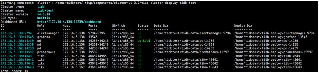

tiup cluster display tidb-test

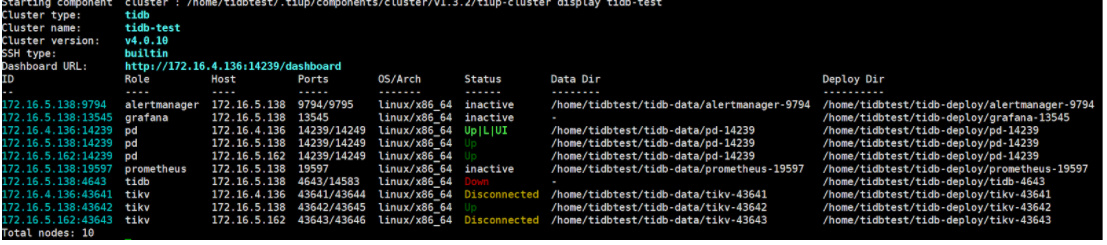

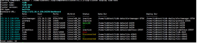

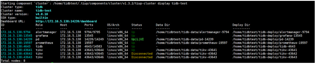

查看集群状态

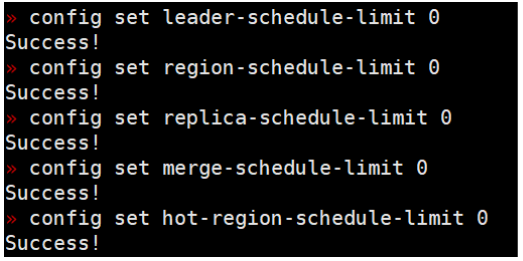

tiup ctl pd -u 172.16.5.138:14239 -i
config set leader-schedule-limit 0
config set region-schedule-limit 0
config set replica-schedule-limit 0
config set merge-schedule-limit 0
config set hot-region-schedule-limit 0

关闭的节点通过 display 查看状态是 Disconnected

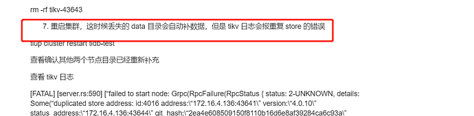

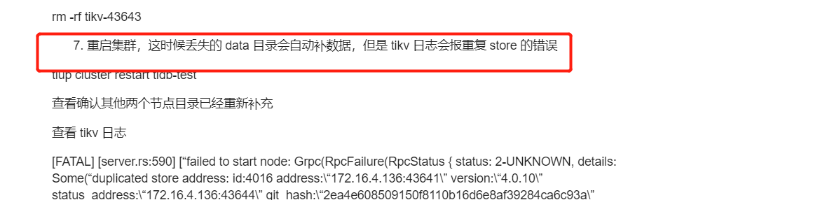

  1. 重启集群,这时候丢失的 data 目录会自动补数据,但是 tikv 日志会报重复 store 的错误
tiup cluster restart tidb-test

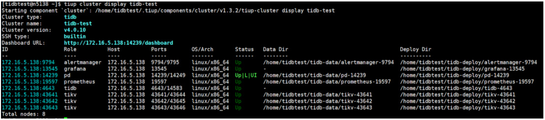

查看确认其他两个节点目录已经重新补充
查看 tikv 日志
[FATAL] [server.rs:590] [“failed to start node: Grpc(RpcFailure(RpcStatus { status: 2-UNKNOWN, details: Some("duplicated store address: id:4016 address:\"172.16.4.136:43641\" version:\"4.0.10\" status_address:\"172.16.4.136:43644\" git_hash:\"2ea4e608509150f8110b16d6e8af39284ca6c93a\" start_timestamp:1614139043 deploy_path:\"/home/tidbtest/tidb-deploy/tikv-43641/bin\" , already registered by id:88 address:\"172.16.4.136:43641\" state:Offline version:\"4.0.10\" status_address:\"172.16.4.136:43644\" git_hash:\"2ea4e608509150f8110b16d6e8af39284ca6c93a\" start_timestamp:1614133151 deploy_path:\"/home/tidbtest/tidb-deploy/tikv-43641/bin\" last_heartbeat:1614137661726372908 ") }))”]

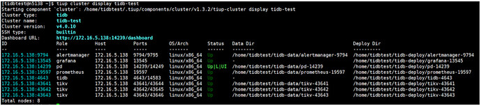

查看集群状态
