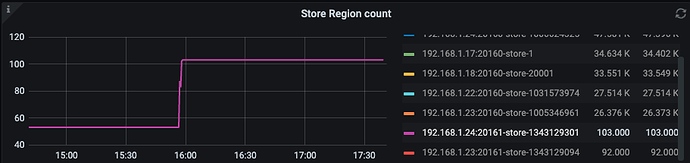

【遇到的问题】

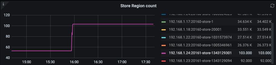

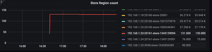

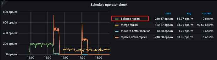

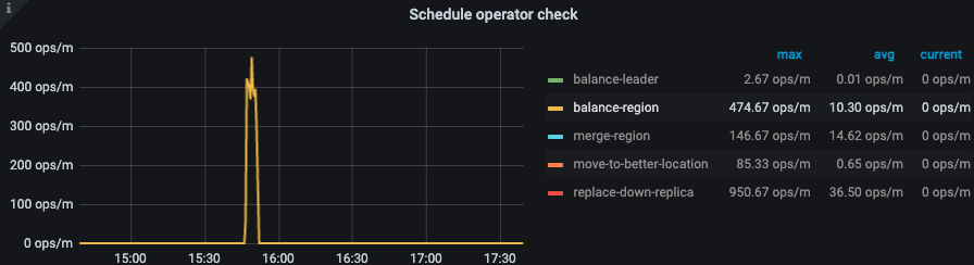

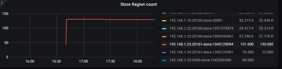

1、刚扩容的时候是有在 blance region 的,后面突然就停了
2、region count 也是上不去

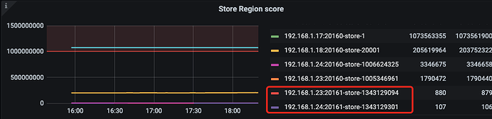

一、store 打分
新扩容的节点分数较低,合理

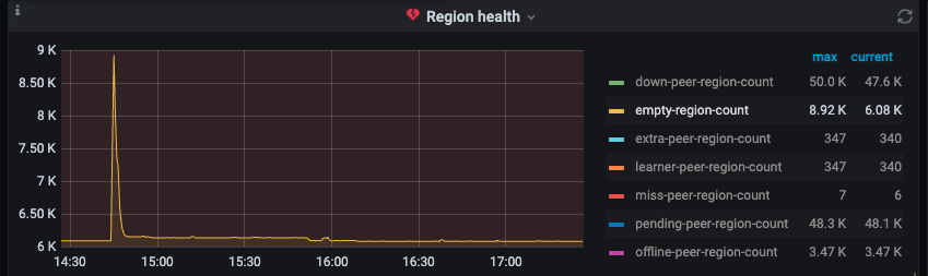

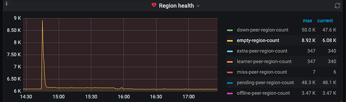

二、排查空 region 或者小 region

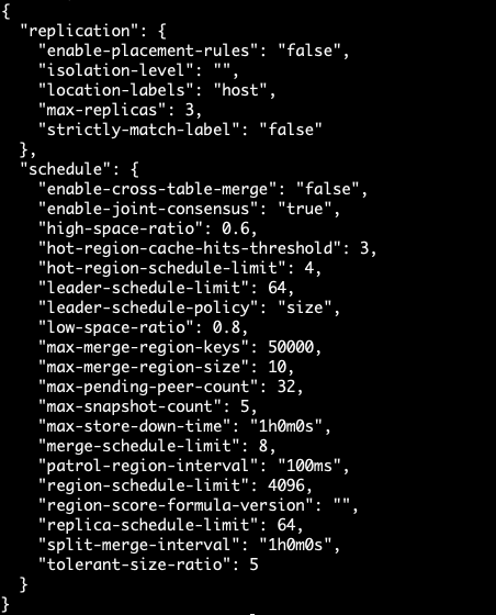

开启了 region merge ,并且调大了这些值
"max-merge-region-keys": 50000,
"max-merge-region-size": 10,
但是空 region 还是很多

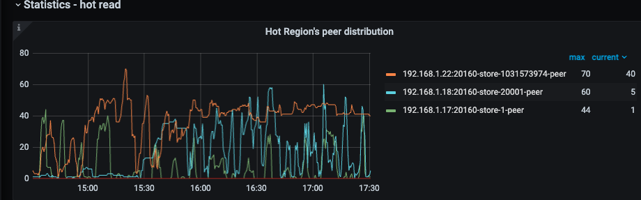

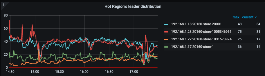

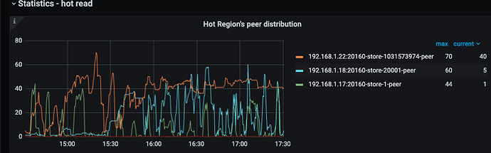

三、热点负载问题
  • 写热点
  • 读热点
没有明显的热点问题
四、调整 leader-weight 和 region-weight
1、在新扩容的两个节点调整权重 leader = 1 ,region = 2
{"id":1343129094,"address":"192.168.1.23:20161","state_name":"Up","capacity":"1.455TiB","available":"1.381TiB","used_size":"190.3MiB","region_count":92,"region_size":841,"leader_count":52,"leader_size":544,"region_weight":2,"leader_weight":1}
{"id":1343129301,"address":"192.168.1.24:20161","state_name":"Up","capacity":"1.455TiB","available":"1.381TiB","used_size":"1007MiB","region_count":103,"region_size":4232,"leader_count":67,"leader_size":3101,"region_weight":2,"leader_weight":1}
2、刚调整的时候 balance 了一会,突然又不行了!

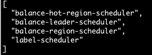

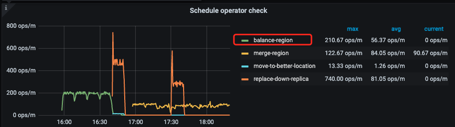

五、排查 operator 调度的问题
1、调整调度的参数
2、怀疑是原来 24 TIKV 节点缩容占用资源,所以把 offline 也关掉了
config set disable-replace-offline-replica true

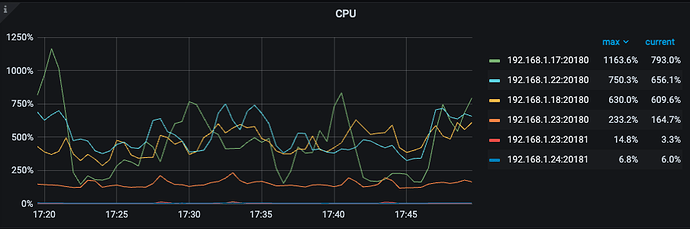

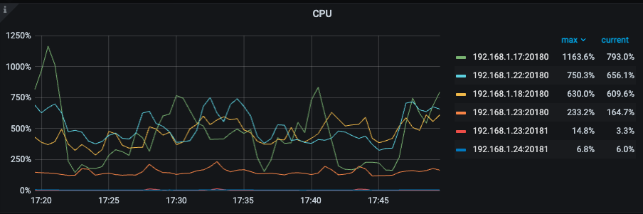

3、cpu 使用情况还好,都是很高配置的服务器
4、调度器正常

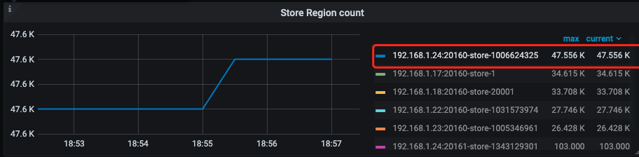

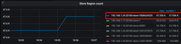

1、下线的节点 leader 已经没了,不过很奇怪,明明我已经下线了两天了,这个 region count 居然还在增长
  • 我早上 9 点查看下线节点的 region count = 47470
{"id":1006624325,"address":"192.168.1.24:20160","state_name":"Offline","capacity":"0B","available":"0B","used_size":"0B","region_count":47470,"region_size":3356788,"leader_count":0,"leader_size":0,"region_weight":1,"leader_weight":1}
  • 刚刚我查看到的 region count = 47518
{"id":1006624325,"address":"192.168.1.24:20160","state_name":"Offline","capacity":"0B","available":"0B","used_size":"0B","region_count":47518,"region_size":3360487,"leader_count":0,"leader_size":0,"region_weight":1,"leader_weight":1}

1、其他原有的 tikv 节点报错:
[2022/06/17 14:41:56.554 +08:00] [ERROR] [peer.rs:3506] ["failed to send extra message"] [err_code=KV:Raftstore:Transport] [err=Transport(Full)] [target="id: 1342871147 store_id: 1006624325"] [peer_id=1321014496] [region_id=1314142866] [type=MsgHibernateRequest]
[2022/06/17 14:41:56.690 +08:00] [ERROR] [peer.rs:3506] ["failed to send extra message"] [err_code=KV:Raftstore:Transport] [err=Transport(Full)] [target="id: 1342887108 store_id: 1006624325"] [peer_id=1338000854] [region_id=1338000851] [type=MsgHibernateRequest]
2、但是新扩容的两个节点没有报错
我 SQL 查询发现这个节点的 region 基本上都是 DOWN 的,有几个是 PENDING 的

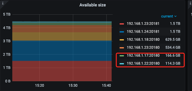

  • pd 的日志有显示两个 tikv 节点容量不够的问题,但是其它节点是充足的
[2022/06/17 14:36:46.931 +08:00] [WARN] [cluster.go:513] ["store does not have enough disk space"] [store-id=1031573974] [capacity=787438190592] [available=114353913856]
[2022/06/17 14:36:51.338 +08:00] [WARN] [cluster.go:513] ["store does not have enough disk space"] [store-id=1] [capacity=1913806786560] [available=166896963584]
  • 其他 tikv 节点能够连上 pd,我在怀疑是不是因为缩容的节点并不存活导致的,因为这个节点有问题,我才选择把它 stop 掉的,然后扩容之后才对它进行缩容的,这个流程是否出错了?
low-space-ratio默认值是0.8,看你这个告警,有2个store的剩余容量低于20%了,PD会避免向上面调度region
嗯嗯,这个我知道,但是其他节点是足够的

我发现这个 store 1006624325 (192.168.1.24:20160)的 region 一直在增加,但是进程已经是没有的
[root@localhost ~]# ps -ef|grep tikv
tidb     35162     1  3 Jun15 ?        01:54:12 bin/tikv-server --addr 0.0.0.0:20161 --advertise-addr 192.168.1.24:20161 --status-addr 0.0.0.0:20181 --advertise-status-addr 192.168.1.24:20181 --pd 192.168.1.20:2379,192.168.1.21:2379,192.168.1.147:2379 --data-dir /data/tikv/data --config conf/tikv.toml --log-file /data/tikv/log/tikv.log
root     50280 17471  0 18:53 pts/0    00:00:00 grep --color=auto tikv
