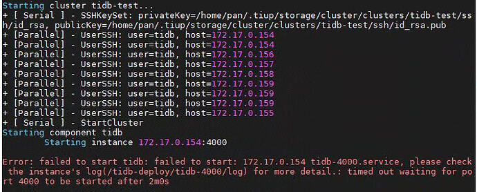

Error: failed to start tidb:failed to start: 172.17.0.154 tidb-4000.service, please check the instance’s log(/tidb-deploy/tidb-4000/log) for more detail.: timed out waiting for port 4000 to be started after 2m0s

Execute command finished {“code”: 1, “error”: “failed to start tidb: failed to start: 172.17.0.154 tidb-4000.service, please check the instance’s log(/tidb-deploy/tidb-4000/log) for more detail.: timed out waiting for port 4000 to be started after 2m0s”, “errorVerbose”: “timed out waiting for port 4000 to be started after 2m0s\ngithub.com/pingcap/tiup/pkg/cluster/module.(*WaitFor).Execute\n\tgithub.com/pingcap/tiup/pkg/cluster/module/wait_for.go:91\ngithub.com/pingcap/tiup/pkg/cluster/spec.PortStarted\n\tgithub.com/pingcap/tiup/pkg/cluster/spec/instance.go:119\ngithub.com/pingcap/tiup/pkg/cluster/spec.(*BaseInstance).Ready\n\tgithub.com/pingcap/tiup/pkg/cluster/spec/instance.go:151\ngithub.com/pingcap/tiup/pkg/cluster/operation.startInstance\n\tgithub.com/pingcap/tiup/pkg/cluster/operation/action.go:405\ngithub.com/pingcap/tiup/pkg/cluster/operation.StartComponent.func1\n\tgithub.com/pingcap/tiup/pkg/cluster/operation/action.go:534\ngolang.org/x/sync/errgroup.(*Group).Go.func1\n\tgolang.org/x/sync@v0.0.0-20220819030929-7fc1605a5dde/errgroup/errgroup.go:75\nruntime.goexit\n\truntime/asm_amd64.s:1594\nfailed to start: 172.17.0.154 tidb-4000.service, please check the instance’s log(/tidb-deploy/tidb-4000/log) for more detail.\nfailed to start tidb”}

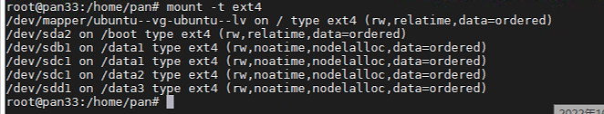

您好,请问在机器上添加数据盘 EXT4 文件系统挂载参数完,check还是说mount point / does not have ‘nodelalloc’ option set
没挂上去吧,你在/data1,/data2 ,/data3 写入数据试试
用mount命令检查,是有的

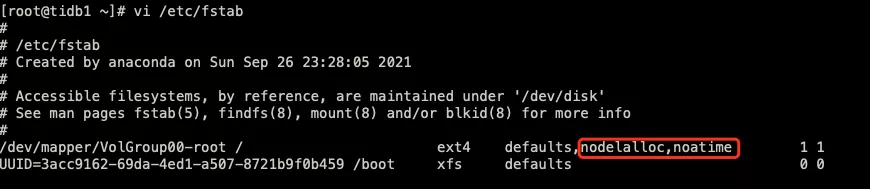

check完说mount point / does not have ‘nodelalloc’ option set
mount point / does not have ‘noatime’ option set
编辑/etc/fstab文件,增加nodelalloc和noatime的配置,配置如下
需要对照你自己的环境,对着文档搞,不然还是会检查不通过的 (PS 上面只是一个例子)
